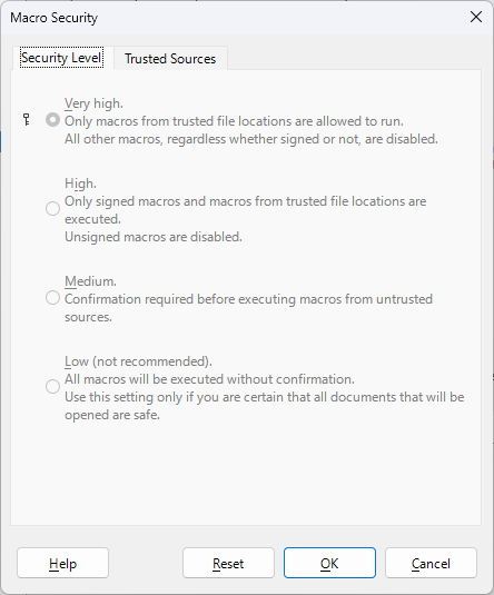

I do exactly that - use the correct name and the correct structure. Also I take the notice about oor:finalized into account, and add that (with value of true) to the MacroSecurityLevel node in the text. And also, I tweak the wanted level to 3. And guess what?
Your common.xcu (why XCU?) - which I blindly copied with only minor tweaks in my reply above, uses completely different structure. No wonder it doesn’t work…
