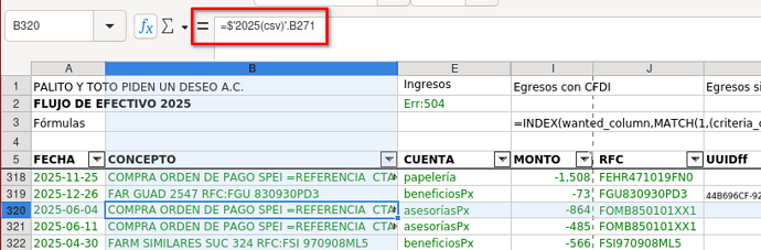

How to show all very long content of cell when actual value is a formula?
Could it be temporarily, but very important, not for the whole sheet.
What I want to achieve is to show the content of a cell, which is a very long text, but is the actual result of a formula. So in Formula bar I have the formula, shown as content. The width of this column is narrow enough to show at once other multiple needed columns in my Calc sheet. I need all those columns at once, but the one with long text could be shown temporarily.
Is there some shortcut, command or button to help with that?
