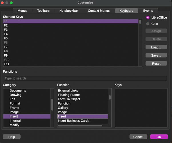

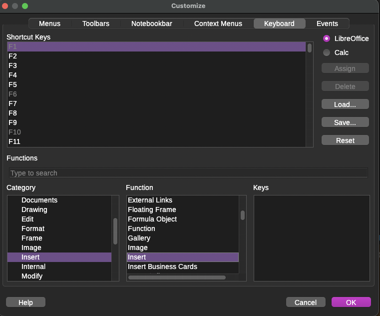

I have made a screenshot of The Customise options. There doesn’t appear to be any key assigned to Insert or Get Help Online function. If I’m looking in the right places?

Your screenshot shows the configuration window while you’re under Calc (your question was tagged writer). Notice the radio button labelled Calc. It turns to Writer when you’re under Writer. Clicking on it accesses the settings for the component. You can define two sets of shortcuts: one for a component (Writer, Calc, Draw, …) and one shared by all components. The specific shortcut for a component takes precedence over the shared ones.
Have a look to the shortcuts while you are under Writer and check if a Writer-specific shortcut is defined for Ins.

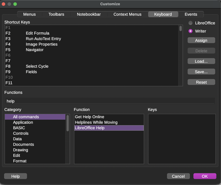

@ajlittoz thanks again, I’ve changed that to Writer.
And looked through the list of shortcuts thrice, though can’t see anything related to Insert key or the help webpage that it opens. Under the Functions list, Insert still appears blank as before in Calc.
F1 key opens the same help page. F1 is shown from the top menu bar under Help/ LibreOffice Help.
Perhaps there’s an error on my keyboard configuration, with Insert key being assigned to this page as well, and at the moment there doesn’t appear to be anything in the customisation to reflect the assigned Insert key.
Your screenshot does not show the current assignment for Ins. Its shows keys F1 to F11.
