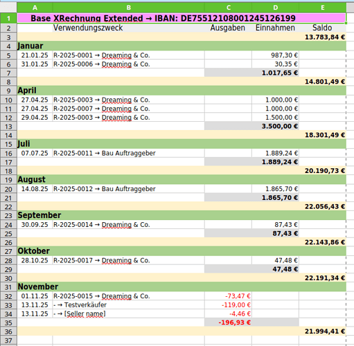

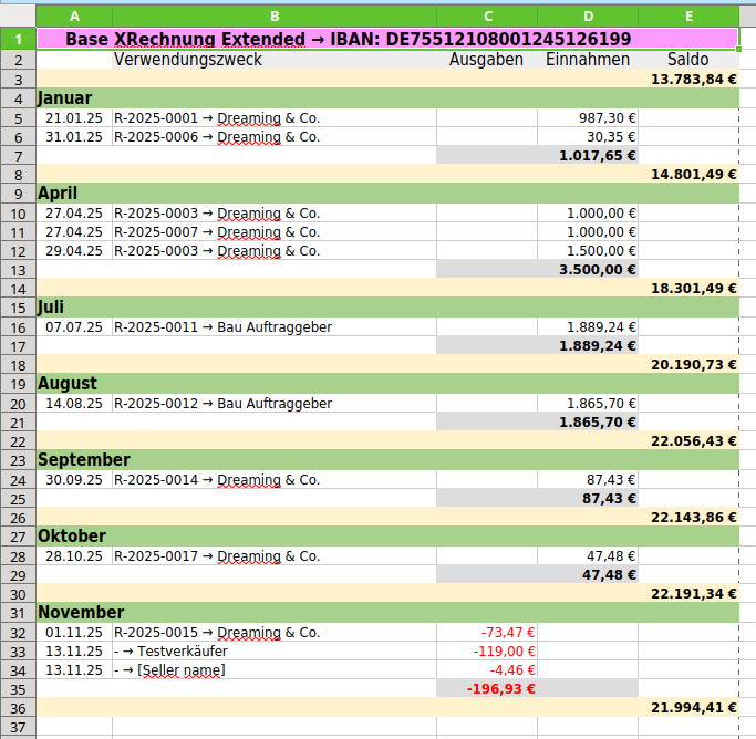

Best way to create reports: All calculations will be made in the database, not in report. Create correlated subqueries for all needed data. Take the query and create a view of this query.
If you try it through the report it will run very slow and often won’t show the expected result (nothing instead of a result…)
Might be you are looking for a report like this. All calculations are made in a view
