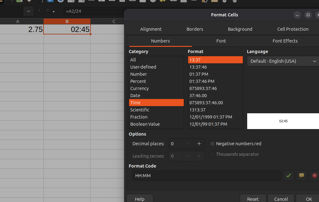

I have tried everything I have come up with on searches and it’s not working. In cell I25, I want to display hours expressed as a decimal number, such as 2.38 hours, to hours:minutes, such as 2:xx. Whatever the result is… it’s about 2 hrs 33 min in this example. FWIW, cell I25’s formula is G7/I24. Currently, as a decimal number, it’s 2.38. I can’t find any format such as h:mm in the program and have tried inserting various custom formats that I have read about but nothing has worked. I get weird numbers. The Calc version is 25.2.5.2, Windows 11.

I did a Format Cell of Cell B1 as HH:MM as member fpy suggests below.
It displays 22:00
Why doesn’t it display “2:45” ?

FPY… I already tried your method. It does not display as 2:33 (2 hours 33 minutes) or thereabouts, which is what I would expect. It displays it as 08:49. Yes, I included the Format Code of HH:MM.
Using your example, if I type 2.75 in cell G27, in I25, it displays 22:00, not 2:45
What have I done wrong?

as shown previously : unit is day, so need to divide by 24 to get hours
What you experience is a consequence of a very old mistake:
Formats specially created to display TimeOfDay (TOD) values in a traditional way (using 2 levels of sexagesimal subdivisions of the hour) can be misused to “communicate” durations…
  1. This requires to accept the day as a kind of mandatory unit.
  2. Used the ordinary way it suppresses multiples of 24 hours which is often contained in such values representing the date as an integer number.
  3. A modified format like one with the code [HH]:MM helps to increase confusion: It shows the value as if it’s given basically in hours: Technically a value allowing such a formatting is still a value in days.
If you actually want to get the number of hours for a duration (as a decimal fraction) you need to multiply the given Date-TOD value with 24, the number of hours per day.
