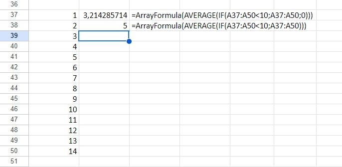

Google Sheets behaves the same way:

In Excel, this effect is also observed (difference in the results of formulas), but it is clear there.

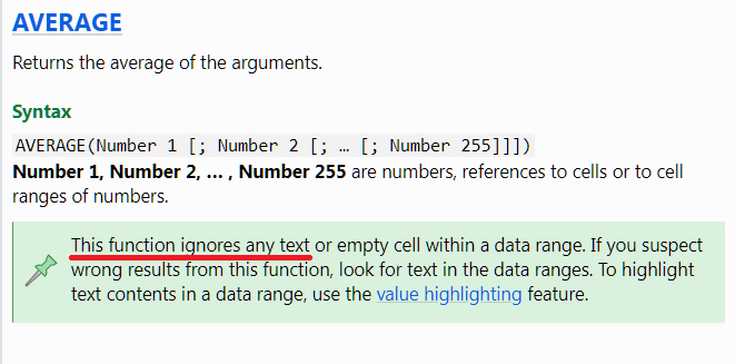

In B3: your A3:A16<10 will select cell range A3:A11, ignoring A12:A16. Since there is no “else” alternative, the returned matrix is A3:A9 augmented by “void” entries. Therefore, the average is computed on 9 values giving 5 as you can manually check.
B4 defers from B3 only in providing a string for discarded values. This doesn’t change the previous result. Either the returned matrix is limited to A3:A11 as filtered by the boolean expression, or the same plus 5 string entries which are ignored by AVERAGE(). In any case, the average is computed only on 9 values.
In B5, you provide a 0 for discarded entries. 0 is a number. Thus A3:A11 extended with 5 numbers contains 14 numeric entries. This changes the denominator in the computation.
B6 is troublesome. Discarded entries are replaced by FALSE(). “Boolean” is not a separate datatype for Calc. Buit-in help says that 0 is FALSE and all other values are TRUE. Consequently, your A3:A11 is again extended with numeric entries which results in the matrix having 14 “valid” entries.
Behaviour may look complicated but results are consistent. The matrix expression always returns 14 entries. Those which pass the boolean test are taken from the “then” argument, those which don’t from the “else” argument. The tricky point is to design the “else” argument so that it returns invalid entries if the goal is to filter the source matrix. Void values seem to be best. However if the goal is to eliminate the influence of non-passing entries without changing the total number, then the “else” argument must return values which are neutral for the outside computation.
