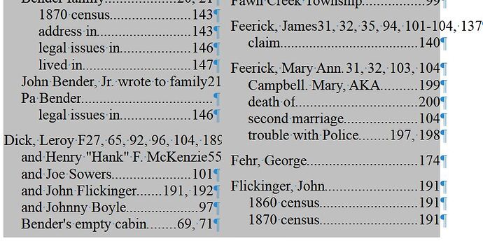

I needed to update some index info, but when I looked at .odt file Index format was incorrect. The page numbering (Entry, dots, Page Number) did not carry on to a second line. I added a sample of how both columns look with many page number entries. I am not sure what changed, my saved PDF files are correct.
I was able to reproduce this problem by adding an entry with many page number entries.
I had a similar issue in 2022, and have tried the advised suggestion, but with no luck.
I have tried working through page styles and also Edit Index, but again no luck, or I am doing something incorrect or out of sequence/order.
