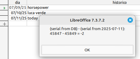

How did you do this?
Reimplement all date+time handling, introduce a date+time cell type in Calc and elsewhere, reimplement calculations with date+time, reimplement number formatting for date+time, write conversions from/to alien file formats like Excel and various other that use a null-date and numeric serial day values (which originally was the reason we have some null-date). Fix the hundred bugs that will pop up for corner cases and unforeseen obstacles. Good luck.
Did it that day when this showed up.
DB (Firebird) is dummy of course. Used it to implement a sub-form filter without the Filter Table method.
How did you do that? I ask specifically what code can be used to see this. Because your screenshot shows, that my change must be reverted.
