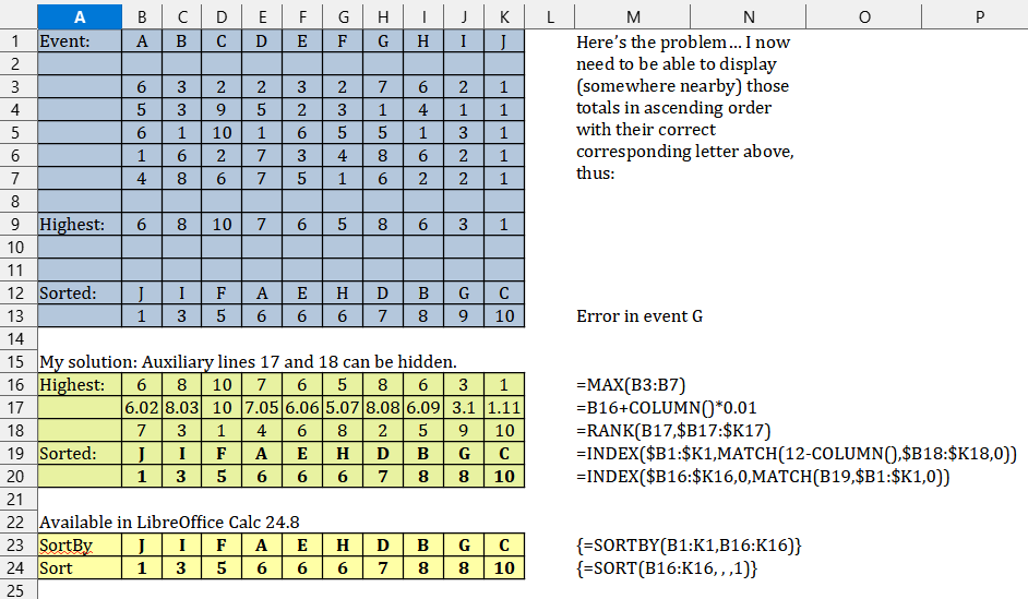

SORT() function it’s being implemented, it will be on the next release 24.8 in August. (126573 – Add array functions in Calc: FILTER, SORT, SORTBY, UNIQUE, SEQUENCE, RANDARRAY)
Meanwhile, you can use the extension
Lox365: XLOOKUP for LibreOffice » Extensions
which has between others the SORT() function.

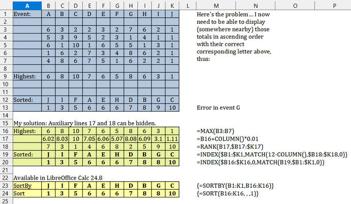

With two auxiliary lines, it is also possible with board tools. You need the functions Rank() and Index() with Match().
Spoolz.ods (40,5 KB)
Brilliant! Thank you so much for this! I’m learning all the time. Thanks again.
