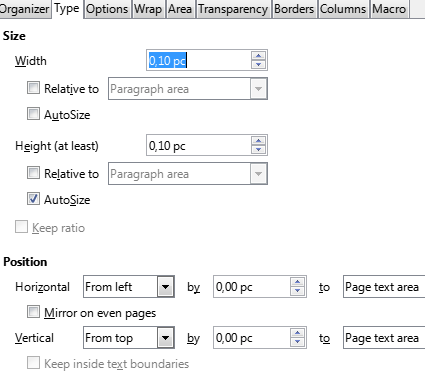

Got it. It was a surpise that I can create a style by clicking the empty space. The issue is still here, but now it is more obvious and easier to reproduce. When I create the style by clicking the empty space and “New”, the position settings on the “Type” tab don’t have paragraph-related options.
  • For horizontal, the available options are “Left page border”, “Right page border”, “Entire page”, “Page text area”.
  • For vertical, the available options are “Entire page” and “Page text area”.
And to see the options that I actually need — “Paragraph area” and “Paragraph text area”, the options that guarantee that a frame will stay in place and will not be moved to the top of the page — will be available only after I change the inheriting of the style from “None” to “Frame”.
Do you have the same “behavior” of settings? If the answer is “yes”, then this is a mystery to me why the frames don’t “move up” in your case.

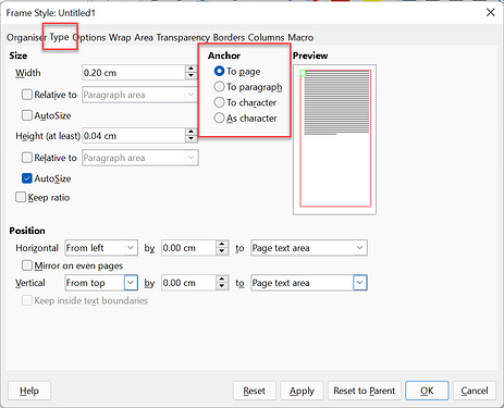

Since the default anchoring mode in the full-fresh “new” creation is To page, change first the anchoring mode to another one, like To paragraph. The positioning options are constrained by the anchor mode (not all possibilities are available in all modes).
Thus not having to tweak inheritance gives you more reliability (as usual).
But I don’t see an option to change anchoring from “To page” to “To paragraph” when I create a frame style from scratch. Where you change it?

What version of LO and operating system are you using? LO 7.1.5.2 on Windows 7 (32-bit) in my case. (upd. I see, you just edited the post.)

There is a drastic change in frame style configuration between 7.1.x and 7.2.x releases.
Before 7.2, you had to create your frame style as a derivative of either Formula or Frame to define the anchor mode, respectively As Character or To Paragraph. This was a serious limitation, opening numerous issues.
7.2 fixed this anomaly. Now, Frame style anchor mode is clearly configured and modified as part of the Type settings. This is one of the improvements in 7.2. If you work intensively with frames (as I do), I highly recommend you upgrade to 7.2.x.
Thanks. This is actually a solution. To fix the issue that is described in the starting post, it was necessary to update to 7.2.2.2. Also, now I create frame styles from scratch.
