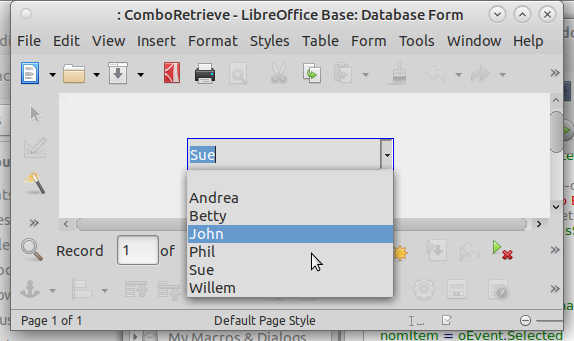

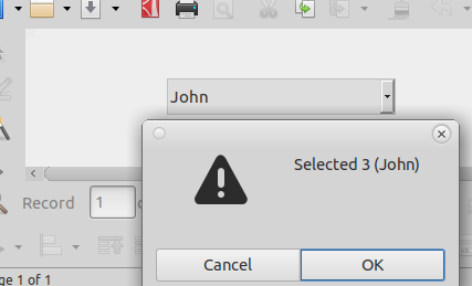

Sub oComboBox_ItemStatusChanged(oEvent As Variant)
Dim nomItem As Long
nomItem = oEvent.Selected
Print "Selected " & nomItem & " (" & oEvent.Source.getItems()(nomItem) & ")"
End Sub

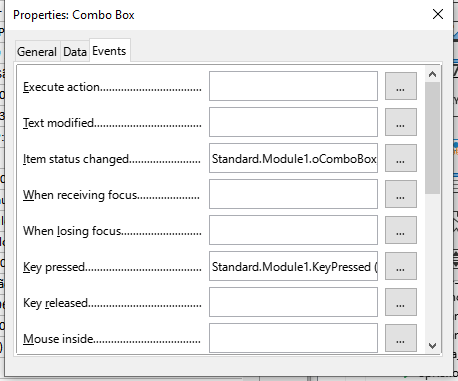

Sorry. It didn´t work. I want to select item by using ENTER key.
The Item Status Changed Event doesn’t even trigger.
The Key Pressed Event triggers.

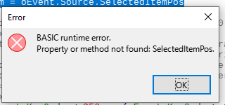

I also tried to use “oEvent.Source.SelectedItemPos”, but I got an error

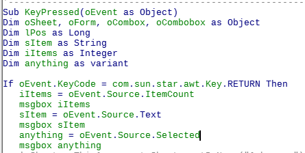

Sub KeyPressed(oEvent as Object)
Dim oSheet as Object
Dim sItem as String
Dim iItems as Integer
Dim x as integer
Dim bFound as Boolean
Dim oCell as Object
If oEvent.KeyCode = com.sun.star.awt.Key.RETURN Then
iItems = oEvent.Source.ItemCount
sItem = oEvent.Source.Text
x = 0
bFound = false
While not bFound and x < iItems
If oEvent.Source.getItem(x) = sItem Then

This worked quite well in my test:
Tested in both Base and Calc - both same result.
