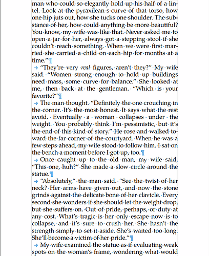

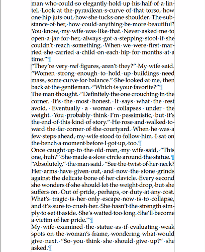

Is it possible to use regular expressions to insert a tab at the beginning of a new, unindented paragraph?
Please see the attached screenshots. “1.png” (the top image) is the text I’m starting with, “2.png” (the bottom image) is how I would like it to look after using regular expressions by means of find and replace (if possible). Normally, I would do this by placing the cursor at the beginning of an unindented paragraph and hit the tab key, but it would be nice not to have to do this for a very long document!
