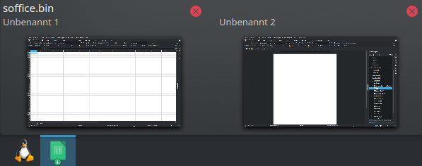

when I open two different LibreOffice applications (e.g. writer and calc), both have the same icon in the taskbar (the specific icon depends on which I’ve opened first).
grafik
grafik
And in the system monitor I see just the first application too. If I quit this one both are closed (e.g. writer and calc).
