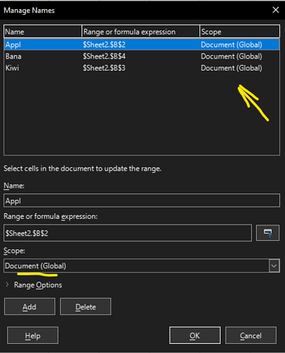

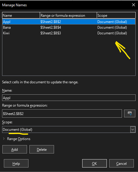

  1. LO updated - was 6.x, now 7.5.2.2
  2. Manage Names > Scope: Document (Global) [always was]
  3. Sheet1 r1c1/c2/c3: Apples 5 =B1*INDIRECT($sheet2.,LEFT(A1,4)) displays #NAME?
  4. Sheet2 r1c1: Apple, r1c2: 1.11 > Name given ‘Appl’

A partial solution for me works as follows:
1 - Sheet2 - Names for cells as described [appl, bana, etc.]
2 - In addition, these names are combined in a group. Name given:- ‘fruits
3 - Caveat:- the range of the group [fruits] must be as LEAST as long as the list in sheet1 but can be longer. So if I have 20 entries [r1 to r20] sheet1 the range of ‘fruits’ must be at least from row 1 to row 20 [sheet2 !!!] which is quite weird.
4 - The working formula in sheet1 [r1c3] is now
=B1*INDIRECT(LEFT(A1,4),fruits)
The result is the calculated value 5.55.

After reading the request from “Zizi64” to make my file available on the internet, I started the whole thing from scratch. I fiddled around with different combinations and ended up with this solution.
=B1*INDIRECT(LEFT(A1,4),)
Even changing the name of $Sheet2 has no effect on the result of $Sheet1 which is good.
