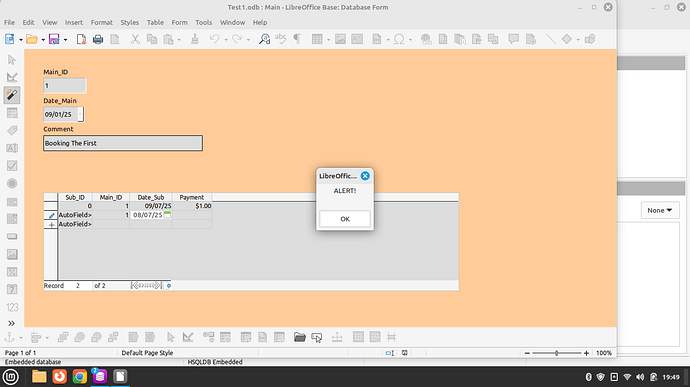

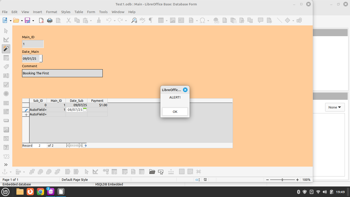

@BrianStew Seems the construction with correlated subquery won’t work for a constraint. AS "a" is needed to get a correlation which will get the only one value from “RecvdDate”.
If the only problem is you couldn’t get the current date in the date field of your form you could try to set the date field as a standalone field, not bounded in a tablecontrol. Might work - couldn’t test here, because I haven’t installed gtk3.
You could also create a macro, which will read the date value from the mainform and sets the “Min. Date” in the properties of the control of the subform. Will have a look tomorrow for an example.
This is a tentative “basic” code just to alert operator for date before booking, so she/he can correct the insert.
Event = After updating Date_Sub
I don’t know if it really works in practice!
Sub Alert(evt As Object)
	Dim SF As object, TC As Object, TCDate As Object, TCMID As Object
	' DECLARE VARIABLES FOR THE QUERY
	Dim Con As Object, Stmt As Object, Rst As Object
	' DECLARE VARIABLES FOR DATA
	Dim dp As New com.sun.star.util.Date, db As New com.sun.star.util.Date
	Dim mid As Integer ' variable for Main_ID
	Dim sSQL As String
	REM SET REFERENCES TO CONTROLS
	TC = evt.Source.Parent ' the grid
	SF = TC.Parent ' the subform
	TCDate = TC.getByName("Date_Sub")
	TCMID = TC.getByName("Main_ID")
	REM INSERT CONTROL VALUES INTO VARIABLES
	mid = TCMID.Text
	dp = TCDate.Date
	MsgBox mid & Chr(10) & CDateFromUnoDate(dp)
	REM CONNECT TO DB AND GET BOOKING DATE
	sSQL = "SELECT ""Date_Main"" FROM ""Main"" WHERE ""Main_ID"" = '" & mid & "'"
	Con = SF.ActiveConnection()
	Stmt = Con.createStatement()
	Rst = Stmt.executeQuery(sSQL)
	' get the quey result
	Rst.next
	db = Rst.getDate(1)
	print "Booking Date is " & CDateFromUnoDate(db)
	' check dates:
	If CDateFromUnoDate(dp) < CDateFromUnoDate(db) Then MsgBox "ALERT!"
End Sub
Or the booking date can be obtained directly from the Main Form without the query. As
FMain = SF.Parent
We can try this simpler way if this “Alert” solution suits you.
Here an example date. In subform the min-date for new entries will be set by the date in main form. If you choose a date before min-date it will be set to min-date. Also added the default date to current date, because there is a buggy behavior of datefields in a tablecontrol and gtk3, which sets the default to a date in the past.

Hi @RobertG .
I loaded your sample and it seems to work OK.
The “buggy behaviour of datefields in a table control and gtk3” I know about, It was me that brought it up last week.
I’ve looked at the event Macro you created and am trying to understand how it all works. LibreOffice Macro’s are new to me and I’m not familiar with the object structure, so I’ll have a play around to get myself more familiar.
Many thankd for your help.
Of course @RobertG 's is the “perfect” solution.
But as you also manifest interest in learning, here is the simple “Alert” code.
I adapted a code from here and only afterwards realized that as booking date is already displayed in the Form, would be absurd to run a query for it.

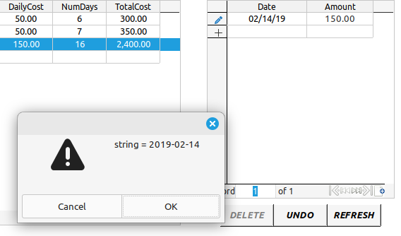

@BrianStew,
I’m uploading a small demo which you may find helpful.
I added the field “DailyCost” to the bookings table.
the form shows bookings, payments and outstanding balance, all 3 use queries as their data source.
the bookings form has 2 calculated fields “NumDays” and “TotalCost”.
the payments form has 2 fields “Date” and “Amount”.
before a record is updated or inserted a macro is fired which checks that payment date is >= bookings received date.
if payment date is < than bookings received date then the update/insert is cancelled.
I don’t think it’s a particular necessity to use table constraints, the way that the bookings form is set up it should be obvious when “StartDate” is greater than “EndDate”.
EDIT: the macro ‘CheckPaidDate’ works but contains an error at line 20.
please replace:
if oPaidDate.string > "" then msgbox("Received Date Is Greater Than Payment Date",16,"WARNING"
with
msgbox("Received Date Is Greater Than Payment Date",16,"WARNING")
Bookings_fb.odb (16.0 KB)
