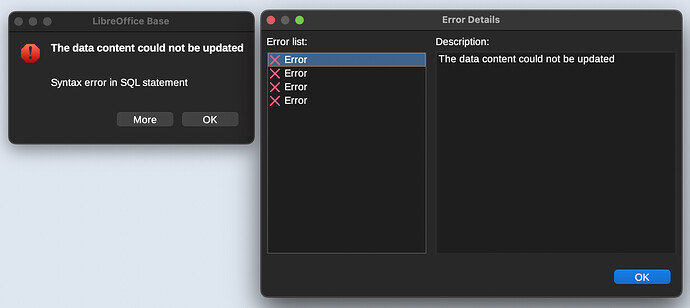

Thanks for the answer, but what do you mean with ‘the tag of the button’, I do not see anywhere in the control property of the button the field ‘tag’? Sorry, very newbie…

Just read the error code: It is missing the parantheses, first (, but the second will be missed also.
Either add this to the tag
('A','À','Á','Â','Ã','Ä','Æ','Å')
or modify the code of the macro.
You have forgotten the brackets:
or you have to change the macro code:
oForm.filter = " LEFT(""lid-naam"",1) IN (" + stFilterContent + ")"
yes, this works well. Thank you very much for your support, you all.
