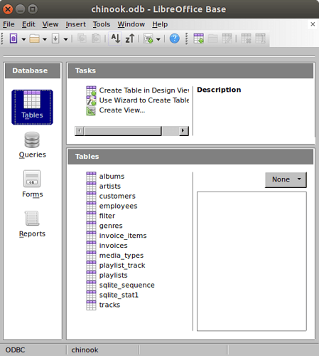

I found a test database “chinook.db” online. This is my connection via Unix ODBC on Linux:
