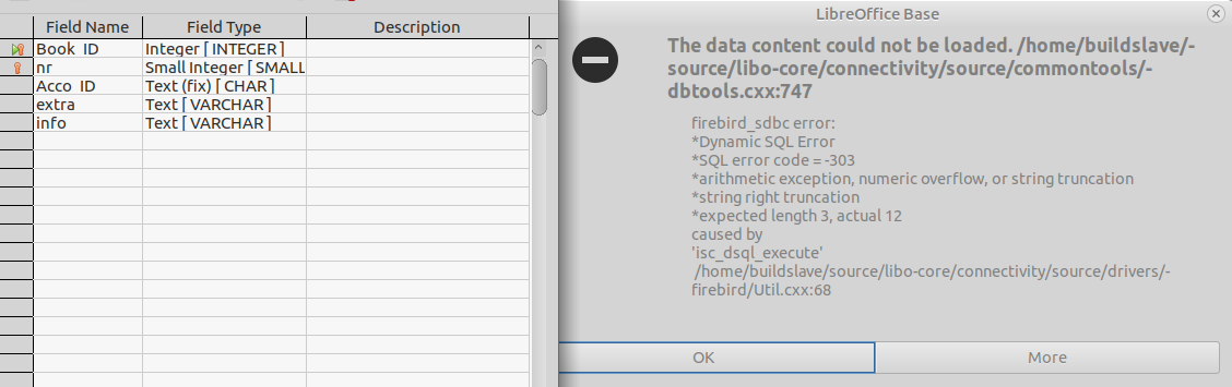

In addition, when I try to establish a link in main & sub forms, and error occurs:
The error (tested on Ubuntu 20 with LO v7.3.1.3) is caused by a Field Type of Text (fix) [Char]. Even though this is stated as a length of 3, the length is 12. Changing to Varchar with a length of 3 seems to work. This appears to be a bug but I do not know if it is already reported. You can check (Bugzilla), and if not found, report.

On the Text (fix)[Char] field, I don’t see a bug reported (doesn’t mean it isn’t there) but it is a bug. With size set to 3 then 12 is set. If I set to 5 then 20 is set and 4 is 16. Seems to be 4X’s the stated size no matter what is actually entered.

Actually the bug does exist (147893)
