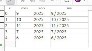

Data source of form = query SELECT * FROM g
Months 7 - 6 were inserted via the Table GUI.
5 - 4 via the Form.
ODBC
LO: 24.2.7.2 (X86_64) / LibreOffice Community
Ubuntu package version: 4:24.2.7-0ubuntu0.24.04.4

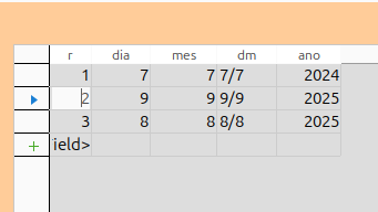

It appears to be inconsistent. I did place the generated column at the end of the row, and got your results, but when the generated column is in the middle of the row, LO seems to lose track. Try changing the column order so that ma is not at the end, then open the table (in Base) and modify a row.
Here it worked.
Inserted 10 | 9 | 2025 directly at DB.
Subsequent inserts did them in the Form, and also updated row 1.
FormTable_g2

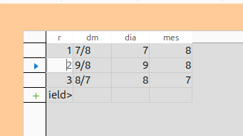

For another table g
| r | dm | dia | mes |
Form generator really losed track, so I needed to explicit columns in the query
SELECT r, dm, dia, mes FROM g;
