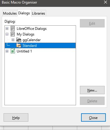

This is the tree for my Dialogs
Libre Office Dialogs
MyDialogs
ggCalendar
Standard
and the ‘Libraries’ tab brings up
My Macros & Dialogs
I have looked at Andrew P and the documentation and cannot see what I should be doing…

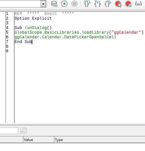

In that case, perhaps you want something like this?
GlobalScope.BasicLibraries.loadLibrary("ggCalendar")
ggCalendar.Calendar.DatePickerOpenSelCell

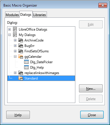

The Tree in Text it is difficult to understand. Does it look like this?
dlgTree
Diaiogs
And you write that the code does nothing for you? Kindly check the macro in this spreadsheet - Loading Libraries (ggCalendar).ods (11.1 KB)

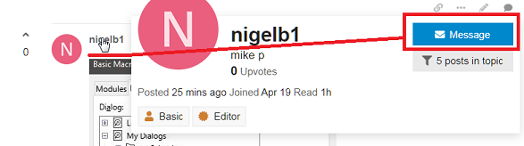

And please don’t post AS QUESTION ANSWERS - it will confuse future readers of this discussion. Use a comment.
Comment
Or we can transfer further discussion to a private chat (there is such an opportunity here)
SendMessage
Sorry, guys. I have no option for ‘Comment’ when I visit the topic, only ‘Suggest a solution’. Something weird has happened to my login.
Yes, John, that works as a sub but not as a line of code in ‘main’.
