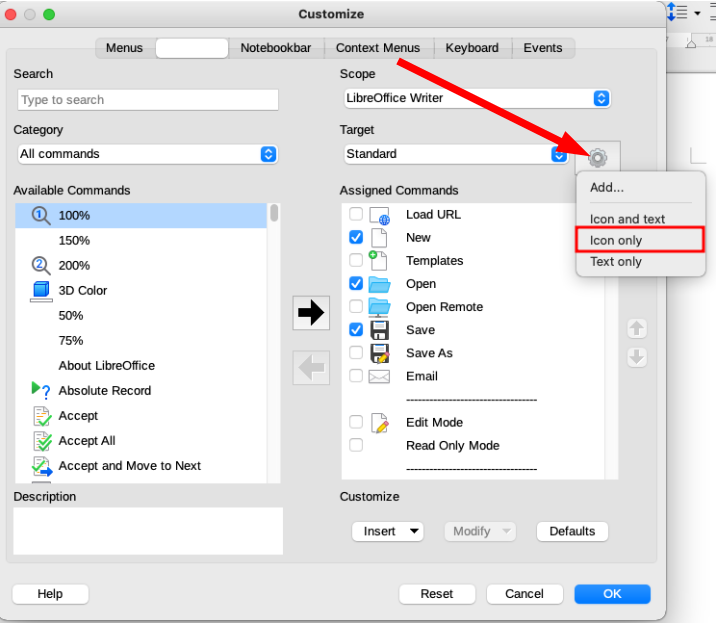

On Writer the top toolbar has descriptions and icons, for example the text ‘New’ and an image of the new icon. These icons are above the standard toolbar - I added them.
How do I remove the text description and leave the icon?
Hello,

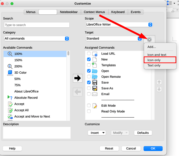

probably you need to:
  • Tools -> Customize -> Tab: Toolbars
  • Select the Target toolbar (e.g. Standard)
  • Click the icon right to the target tool bar
  • Click Icon only
Hope that helps.
That worked. Thanks!
