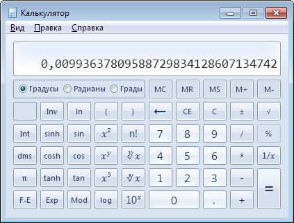

Calling testPPMCON shows:
So - what specifically do you see, and for what input?

okay so basically for example let’s take 437.3, i’ve checked in the ms calculator, google, wolfram alpha, and even pulled out my ti-84, all sources say the same thing, the results is 0.00991609773… etc. aaand what does libre says? 0.00993637… etc.
