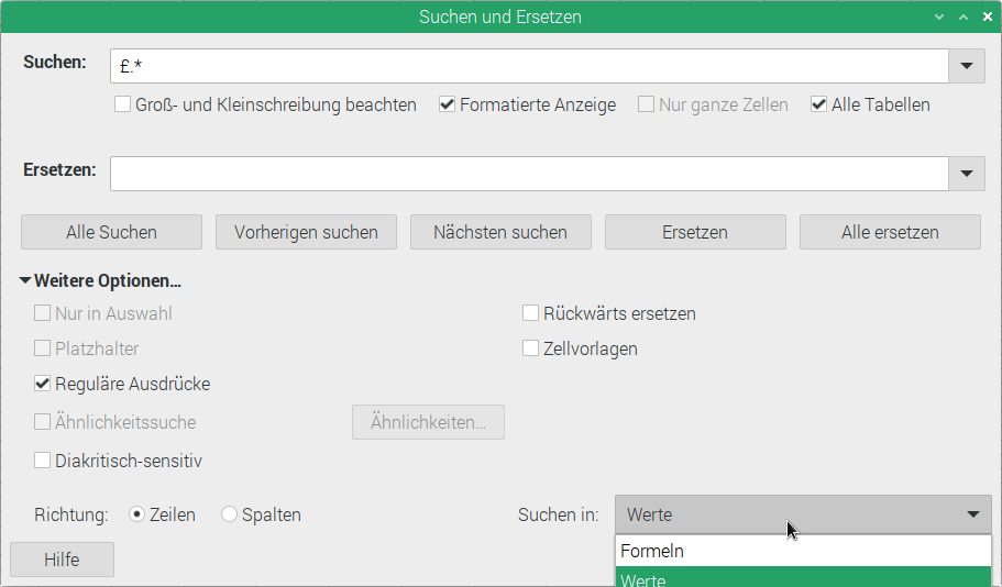

No, it did not work. Here is what it looks like:
Partially done by hand
you did NOT set the Option regular Expression
I can’t see if you use £.* (right) or just £* (wrong)
edit: you need also to set the Option: Search in Values
Lower right in the Screenshot
