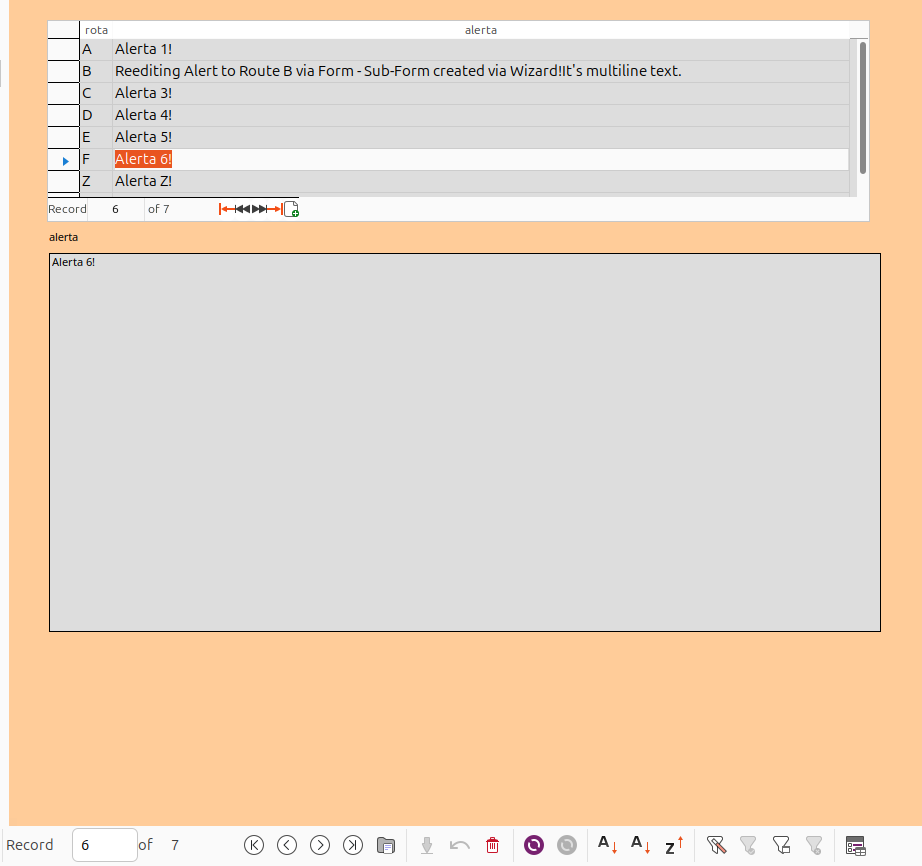

My way to do this is
  • Adding a grid control at the side
  • and using a filter-table to reduce entries
Straightforward solution via Form Wizard.
