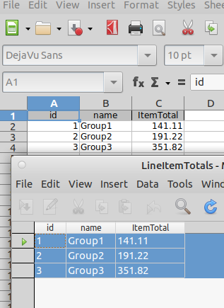

Another option. Open your Base file & run the Query. Click on Upper left corner (blank left of field names). Will highlight all items. Right mouse click same cell & select copy. Then paste in Calc:
Screenshot at 2022-02-17 17-49-35
Thanks, but that only works in WIndows for me, not Linux (Mint). The clipboard remains empty after initiating copy.
Basically, that started this conversation; I used Windows/ Libreoffice last week and the standard copy/past worked fine. Yesterday went back to mint, where it did not work.
