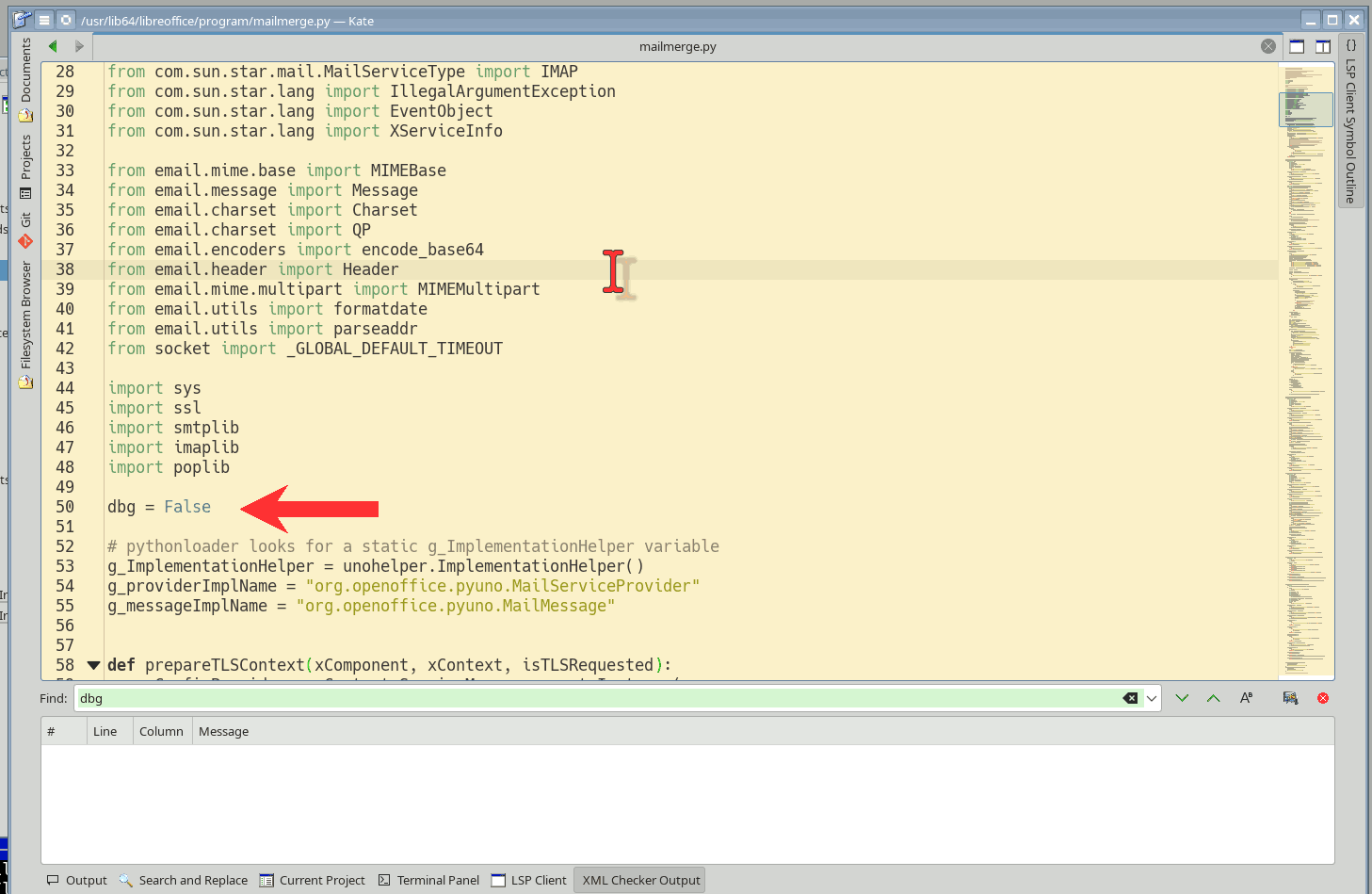

You seem to not enabled the debug output in that PY file, thus no details could be seen.
Change False to True and you will get much more information.
