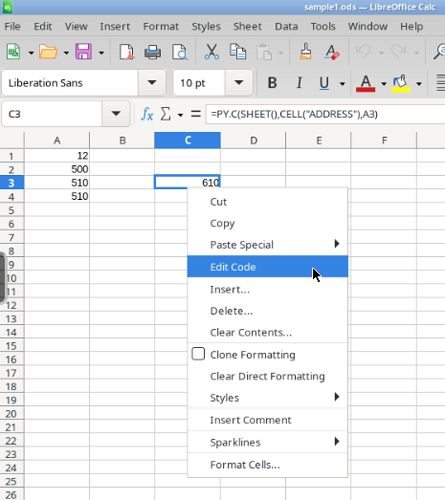

This is the solution I came up with. It seems to work.
Basically I suspend listeners and write the formula again using setFormuls() and Calc treats it like a dirty cell.
def dispatch(self, url: URL, args: Tuple[PropertyValue, ...]) -> None:
self._logger.debug(f"dispatch(): url={url}")
doc = CalcDoc.from_current_doc()
sheet = doc.sheets[self._sheet]
cell = sheet[self._cell]
cc = CellCache(doc) # singleton
cell_obj = cell.cell_obj
sheet_idx = sheet.sheet_index
if not cc.has_cell(cell=cell_obj, sheet_idx=sheet_idx):
self._logger.error(f"Cell {self._cell} is not in the cache.")
return
with cc.set_context(cell=cell_obj, sheet_idx=sheet_idx):
result = self._edit_code(doc=doc, cell_obj=cell_obj)
if result:
if doc.component.isAutomaticCalculationEnabled():
cm = CellMgr(doc) # singleton. Tracks all Code cells
# suspend the listeners for this cell
with cm.listener_context(cell.component):
s = cell.component.getFormula()
if not s:
self._logger.error(f"Cell {self._cell} has no formula.")
return
s = s.lstrip("=") # just in case there are multiple equal signs
cell.component.setFormula(f"={s}")
doc.component.calculate()
And in My log File it show cell formula being fired.
