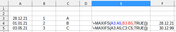

Both calculation (F4, F5) should lead to the same result. Can this be right? What do I miss?
Column E shows the formula in column F. The values in column A and F are dates (dd.mm.yy).
Welcome! No, the function is working correctly.
Try adding =ISNUMBER(B3)
and =ISNUMBER(C3)
to columns G and H. All values in column B are nonzero numbers, so comparing them with the result of the TRUE()
function will give true and MAXIFS()
will select the largest date from column A (a normal MAX()
would give the same result). On the other hand, non-numeric values in column C will not give any positive results when compared to TRUE()
. Therefore MAXIFS()
returns 0, which when formatted into a date gives 30.12.1999
(To be honest, I was surprised by the third parameter in your function - what result did you expect at all?)
Actually no. Comparing the values B3:B5 with TRUE() only B3 matches, as TRUE() is numeric 1, so the content of A3 is returned in F3. Changing B3 to any other value than 1 will return 0.
Yes, I really should have used some rubberduck debugging. I was aiming for a test, that was true in any case. But I mixed things up. Thanks for explaining.
