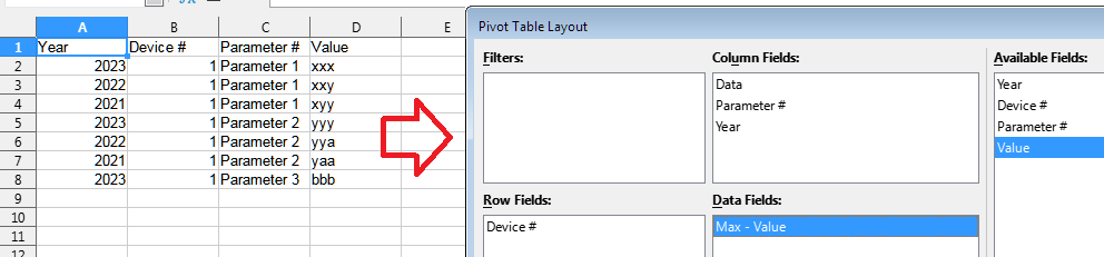

Rather than trying to clarify my question through text, let me just attach a file.
Sample Trend Sheet.xlsx (10.4 KB)
I have 100’s of files with data for the past three years for many parameters - the sample sheet has 17 parameters as an example. I want to automate the process of creation of a summary trend sheet as shown in the 4th tab of the above file.
In other words, you need to parse each of the three tables into separate rows and create a long plaine table and then apply a PivotTable to it?
Well, in principle this can be done in several ways. But please tell me, your files are stored in xlsx format - does this mean that you have Excel? And if so, do you know how to use the tools that are on the Data tab? The fact is that for more than 10 years there has been a tool that was originally called PowerQuery (then it was renamed Transfer&Go, then it was completely deprived of its independent name, but that’s not what we’re talking about now).
For this tool, the “unpivot” operation is built-in. And combining data from different sheets or from different books is also built-in. Perhaps you should look in that direction? Unfortunately, I can’t help with this; I haven’t used Excel for a long time. But perhaps a few thematic videos on YouTube can help you with this?

I think you have 2 basic directions to consider:
a) use cell formulas and sheet linkages in Calc …
b) import data to Base and assemble your desired table/s there - then export results to spreadsheet as you need…
Either will take time, but the database solution is much more scaleable and modifiable in the long run, whereas heavily customised spreadsheets can be very fragile…
