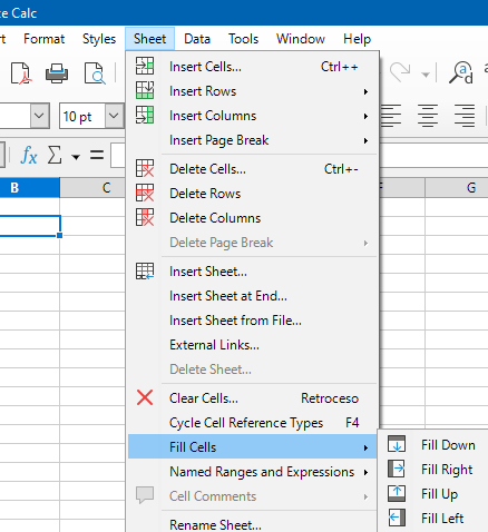

I do find the help hard to navigate, and I have another question. In Calc, cells auto-fill downwards or upwards. Is there a way to make them autofill from the left or the right instead?
If you don’t want to reply that’s fine - it’s probably not your job anyway!
Thanks again,
Oliver
imagen
Thanks again. Unfortunately the “fill” option doesn’t seem to make any difference. I think I had tried that before but I’ll keep looking.
