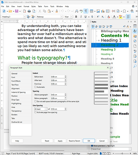

That’s the design book that fails white space design. For example, the lower-order headings crowd paragraph content.
Could you point me to an example? I just downloaded the second edition (ODT format) and did not find any “accident” (but this a superficial browsing).

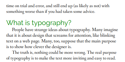

By looking at it with my present expertise level, I found many clumsinesses in formatting.
First page with a lower-order heading: https://designingwithlibreoffice.com/wp-content/uploads/2022/11/DWL-SecondEdition.pdf#page=19
I was trained by a cartographer who would insist on more white space around larger fonts. In the example shown there should be more space below the heading line with the larger font compared to other text lines. (It can be thought of as being like opposing magnetic fields.)
The same issue occurs throughout the book.

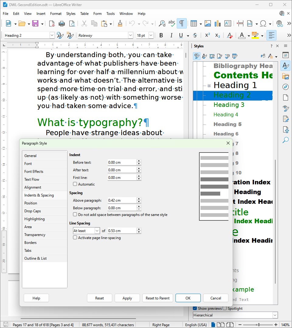

So I took the liberty to change this…

I fully agree with this. But this is not a “weakness” in Writer. Put rather the blame on the author who did not configure his styles accordingly.
When aesthetics is concerned, Writer is a “passive” tool: it accepts blindly what the author requested. It will not spontaneously modify this; otherwise you become prisoner of what developers implemented without the possibility to override it. I think this is worse than keeping debatable author’s choices.
