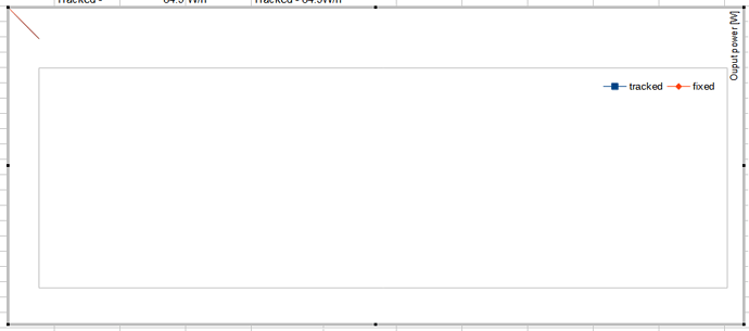

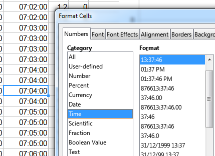

I am using for X axis data formatted as time

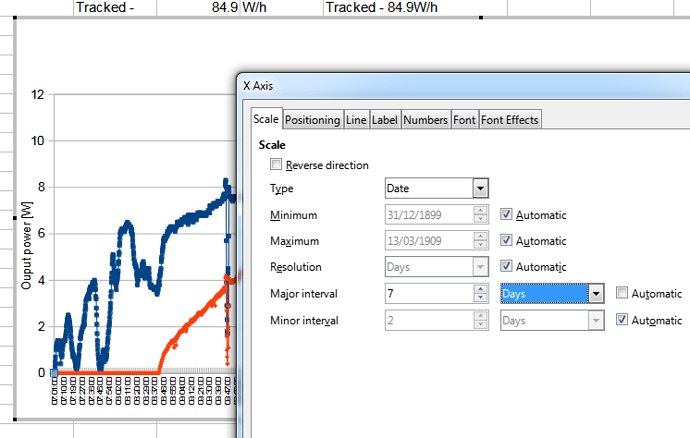

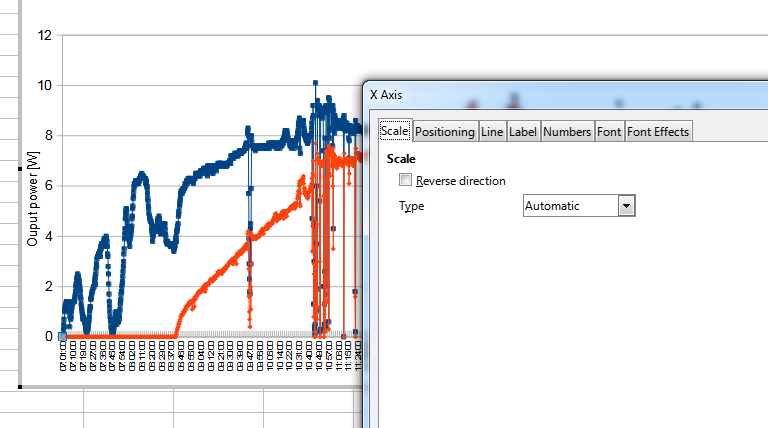

In the chart, there is too much X axis labels, but I can not scale it, because there is no option for Major/Minor intervals in auto mode.

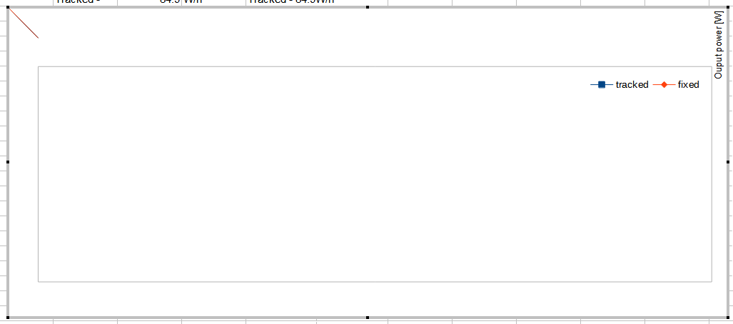

It is only for Date, but I can not change it to date, because if I do, the charts turn to blank due to there is only option for Days, Mont and Years. No option for time.
Any idea how to decrease the number of the labels on X axis? I would like to select time intervals as 7:00:00, 7:15:00, 7:30:00, …

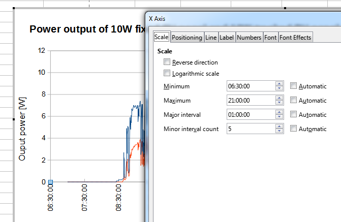

Use an XY(Scatter).
Thank you PKG. What a simple solution. Now it works in XY(Scatter) :slight_smile:
