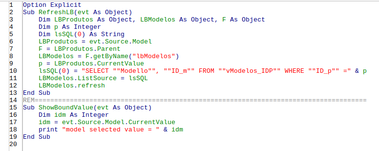

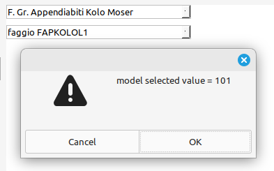

This APPARENTLY works.
REM: DB is the same of Warning message in Forms.
And there there is a @Villeroy 's solution without code, via Filter Table method.
