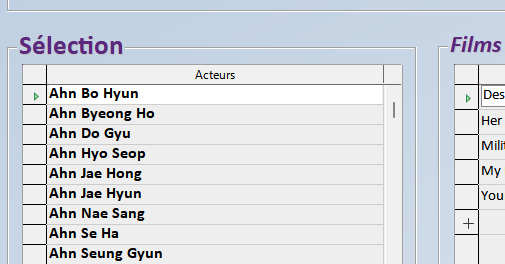

I have in this form, a control table [named Selection] which acts as a select list, so normally all the records in the form appear as a list. It is then easy to select a name and access this recording. The table list still remains intact and complete.
However, when I run this procedure, the control table only shows the record name of the sRecordID as a result. Which is correct, but I lose access to the full list of the control table. If I request a refresh of the form, the first record in the form will show up with the list full list from the select table.
Is it possible that the sRecordID record (this one manipulated by the procedure) is displayed as expected, but with the complete list of the selection table. ? The execution of this procedure was done from a button at the sRecordID record with complete list of the control table which was displayed.
