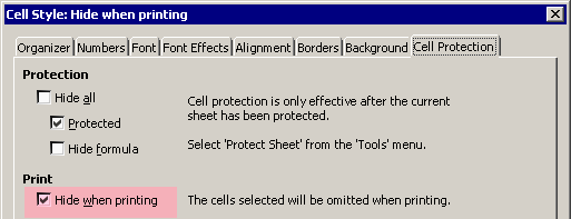

It’s also possible to use conditional formatting applying a style with Hide when printing set for rows where first column is not 1.
That one is a great option, but will leave blank rows.

Hello mikekaganski,
I tried a variation of your suggestion.
Unfortunately, it prints a BLANK row instead for removing the row.
Below is my test case.
(I used the condition “Formula is” because it can always reference the 1st cell.
I was not able to get the condition “Cell value” to reference the 1st cell in all cases.
So this test below was just to test printing, nothing else.)
EXAMPLE for row “9”:
  <Select row "9">
  Format - Conditional - Condition...
    Formula is    $A9    <- reference absolute 1st column cell (if $A9 is not "0", then condition is "true")
    Apply Style: New Style
      Organizer tab
        Name: Hide when printing
      Cell Protection tab
        [CHECK] Hide when printing    The cells selected will be omitted when printing.
      OK
    ADD
  OK
If cell A9 = 0, then the contents of all the cells in row “9” are printed.
If cell A9 != 0, then row “9” is printed as a BLANK row.
It’s a partial solution.
Thank you for your suggestion.

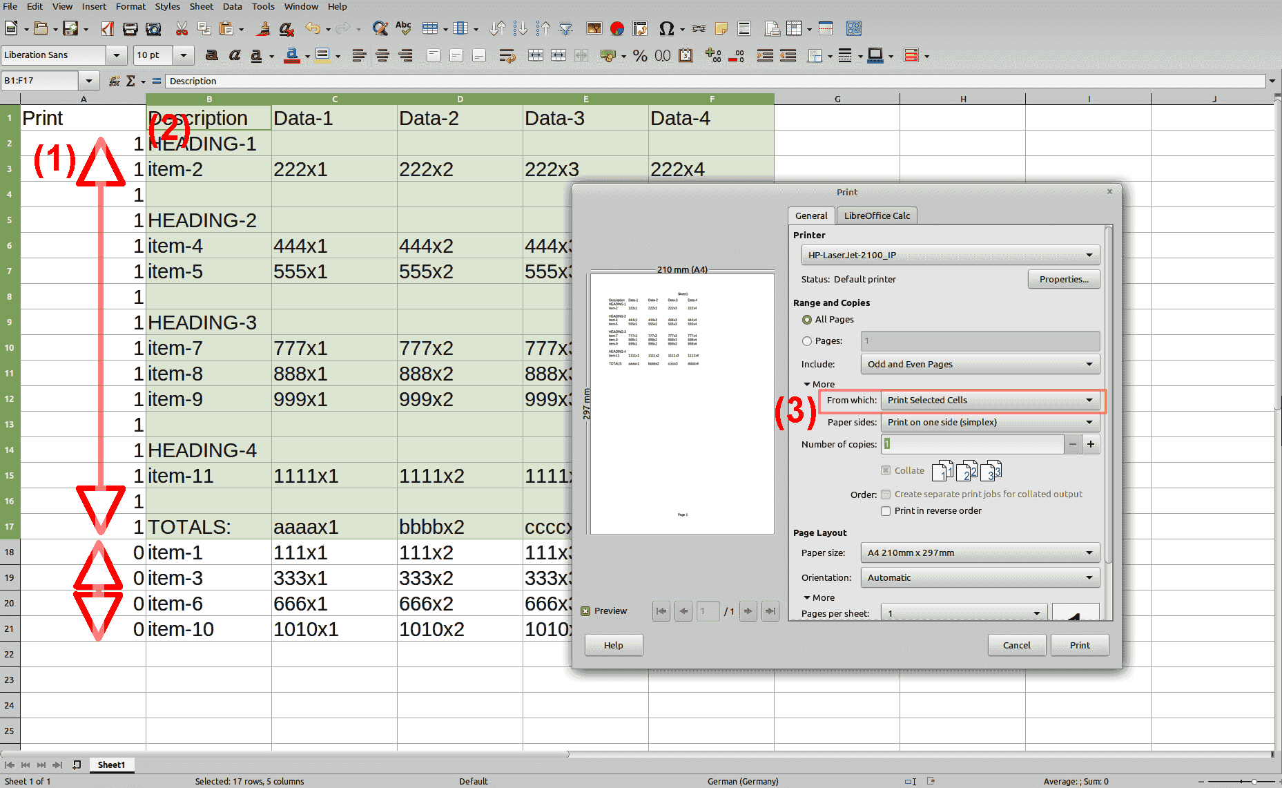

EDIT (hint of @LeroyG)
  1. Sort column 1 (Print → descending)
  2. Select print area
  3. Print selected area
  4. Undo sort
Cheers
EDIT
Also possible: menu DATA → More Filters → Standard Filter → Print = 1 (then select print area or hide column A - hidden column does not print)
After printing, don’t forget to undo.
