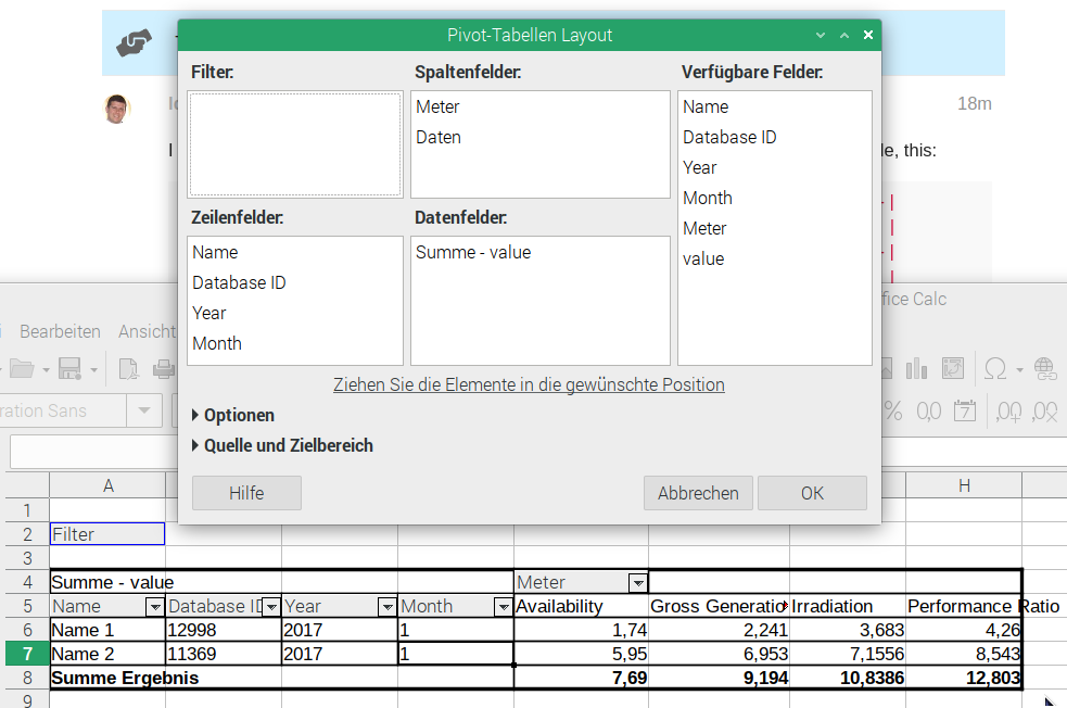

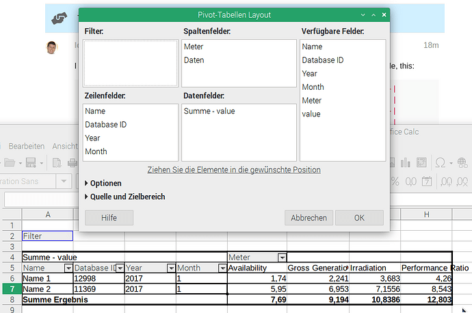

Hallo
Use →Data→Pivottable→create… with »drag&drop« as you see in
