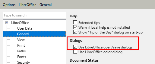

Did you already try the option to use the system’s dialogues for Open/Save?
See > Tools > Options > LibreOffic > General

There are 2 types of FilePicker Dialogs that you can use in LibreOffice :
1) LibreOffice Open/Save Dialog
The LibreOffice Open/Save Dialog does not show hidden files/folders.
To use the LibreOffice Open/Save Dialogs, check the checkbox Use LibreOffice dialogs in the menu Tools : Options… : LibreOffice : General : Open/Save Dialogs.

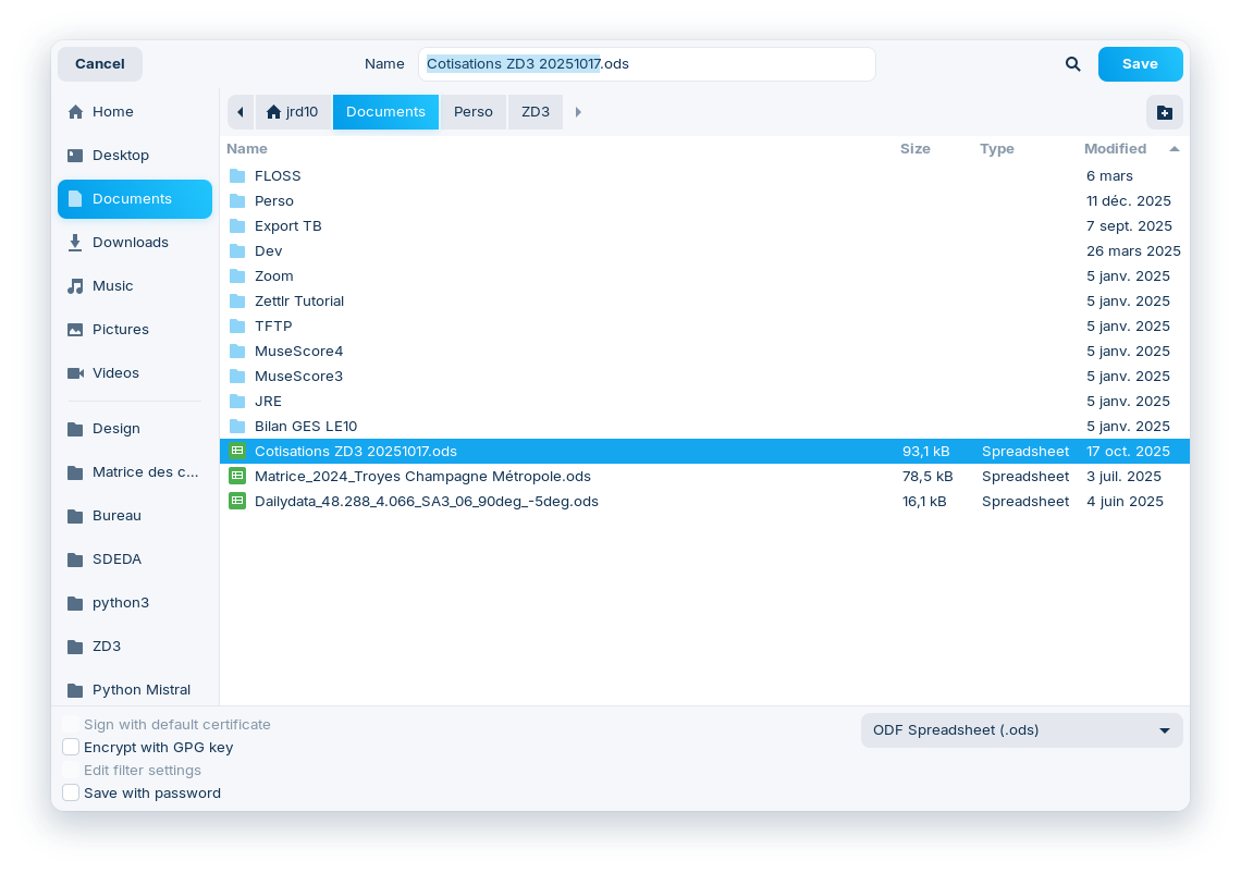

Thank you, @Lupp, on my Zorin OS, it is the solution :). Eight years later!
I guess it is one solution.

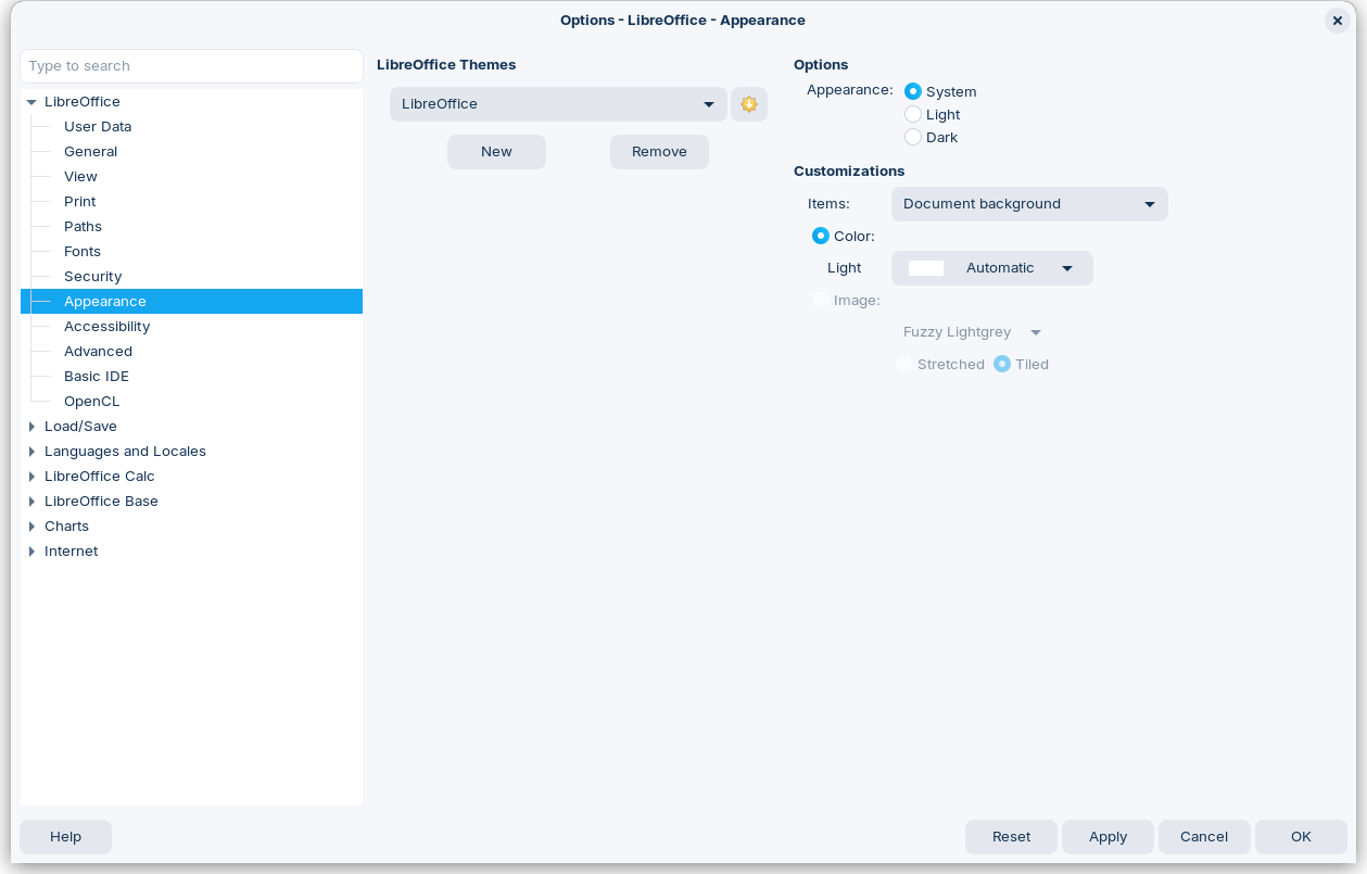

As someone mentioned in the Zorin-thread: It looks like a theme-problem. You denied this and presented a setting for ZorinOS, but did you check “appearance”-settings inside LibreOffice?
Since introducing dark-mode this kind of glitches in UI are more frequent…
I did know! What is it? :slight_smile: . Where can I see that in LibreOffice?
Not in Search Commands :slight_smile:
⇒ Tools ⇒ Options ⇒ LO ⇒ Appearance: ⇒ ⇒

No recommendations possible unless someone uses also your combination of LibreOffice and ZorinOS.
As this is about a workaround for a bug:
Just try some of the available Themes (in a folder, where you are sure to find some files) and you may find a theme showing the files in the dialogue.
