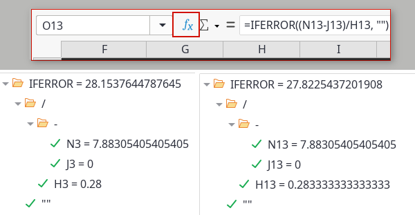

If I enter in cell H3 the formula =17/60 then both calculations match. It is a rounding error.
What helps me in these situations is to click the Function Wizard button to see the actual values and not the formatted values. I almost think there should be a feature to toggle formatting, or don’t format until done, or never format to add or remove decimals, always use a version of round.
