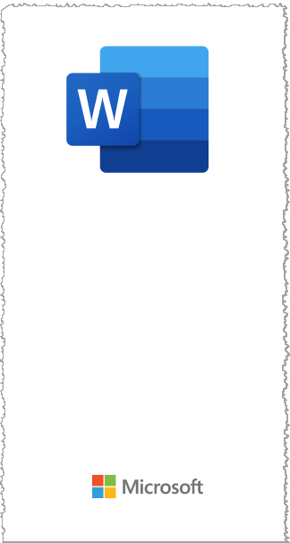

However, nothing can be selected at your link. There are only two logos visible, the rest is white page. You can’t click anywhere?

I tried to upload that file four times to Google Drive but there was a persistent error, so I tried OneDrive and that’s the link I copied from the Share option there after the upload was completed. After your warning above I tried to open the file with the online version of Word and also got an error.

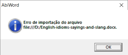

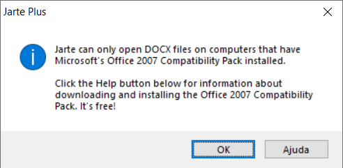

FYI I installed two portable word processors to see what would happen if I tried to open that file with them. The results:
Jarte warning
Abiword warning
This is Brazilian Portuguese and says “Error importing file”.
I thought this Office 2007 Compatibility Pack perhaps may lead us to some solution. What do you think?
