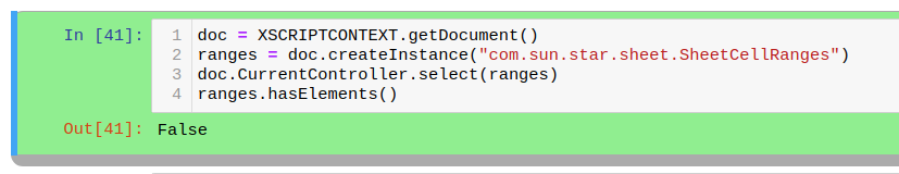

This used to be a slightly absurd method to unselect any range selection, so the active cell remains. It still works like that. It boils down the current selection to the active cell.

What’s the point of doing nothing code? This is a trick. Removing the highlight by passing the empty range collection. I have it orange-red.
NOTE: Same with .SheetCell or .SheetCellRange doesn’t work.
	With ThisComponent
		.CurrentController.select(oCell)
		oRanges = .createInstance("com.sun.star.sheet.SheetCellRanges")
		' Remove the highlight by passing the empty range collection.
		.CurrentController.select(oRanges)
	End With
