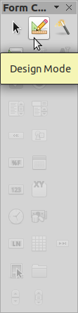

I created a push Button to assign a macro. I have created the buton and asigned the macro and tried the button nothing worked so i wanted to edit the button but cannot get to the properties of the button

Not specific as to the button used. If this is a control on a form are you in design mode?
Get there from Form Controls toolbar:
