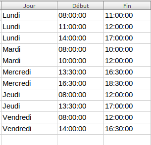

Thanks, but I don’t quite understand. The following screenshot is the schedule for operator OPE_ID = 1.
screenshot
For example, for mardi (tuesday) the schedule shows 8:00 to 10:00 and 10:00 to 12:00. What I’m looking for is for the query to indicate the free hours between 8:00 and 18:00, i.e. for this example → 12:00 to 18:00.
But I’d also like to be able to indicate a time slot during which the operator isn’t working; for example, between 12:00 and 13:30. In this case, the hours available for this day would be from 13:30 to 18:00.

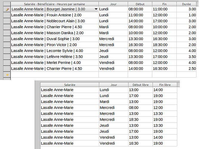

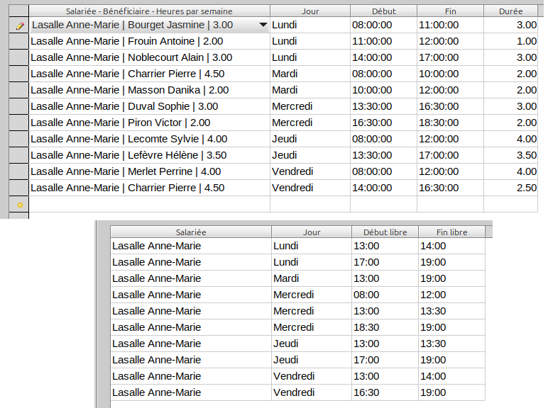

Here’s what it looks like with the following time slots:
  • From 8:00 to 12:00
  • From 13:00 to 19:00
So visually you have a perfectly clear view of the free slots (it could be even more complicated with customized slots for each operator).
Thank you both… :slightly_smiling_face:
