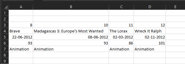

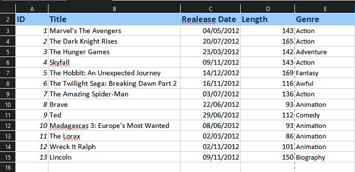

Here, is the Excel Data Screen Shot
Here, is the Result ,After Running VBA Macro Code
and

This procedure will do what is shown in your screenshots.

and The Sceen Shots of your Code in Same Calc Document Using copyRange
1 ) Based On your Code … I Write The Macro Code For Two Different Calc Documents, that is Source Data in One Calc Document ( Doc1 ) and Destination or Results Will be Placed On Another Document ( Doc2 ) in Two Separate Sheets.
2 ) Based On your Code - I Slightly Modified, WithOut Using “CopyRange(target.CellAddress, SourceRangeAddress)”

Here Is the Source File and Screen Shots
Same Calc Document
SourceFile
