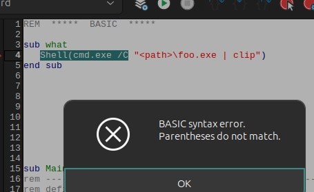

If I run this in Shell(), the executable file runs, but nothing is sent to the clipboard.
The following also doesn’t send the output to the clipboard.
Shell("cmd.exe /C ""<path>\foo.exe | clip""", 2,,True)

I typed from memory. That should be
Shell("cmd.exe /C ""<path\foo | clip""", 2,,True)
