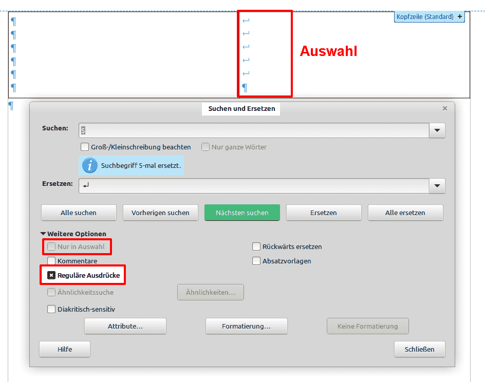

You can work this way on regular SEARCH&REPLACE tool:
  1. Create a line feed ↲ and copy it into the clipboard
  2. Start SEARCH&REPLACE and search all paragraphs $ (regular expressions)
  3. Leave (close) SEARCH&REPLACE - the ¶ are still selected
  4. Insert clipboard (↲) per CONTROL + V and it will replace each ¶
On Linux you may insert the ↲ as follows in the replace box:
CTRL+SHIFT+U 000a (and enter).
EDIT
In no. 3 I added: (close) - for better understanding.
@Grantler Ctrl+V of ↲ to Replace isn’t functional on Win.
Next possibility for F&R in selection is use standard F&R: Find $ and Replace @@@ that is some delimiter that isn’t used in document.
And then use AltSearch: Find @@@, Replace \n and Replace all.
First you have to “3. Leave SEARCH&REPLACE”. Then you insert ↲ in the document.
@Grantler OK, functional :+1:
Find $ and Find All → it will select all Enters
then close the F&R dialog and Ctrl+V will replace all selections with pasted symbol

On LinuxMint 21.3 (and other versions) - Mate display
Ctrl+Shift u000A returns LF symbol ↲
inside text area and/or in REPLACE display (German: Ersetzen: in screeshot).
I wonder whether 000a or a or A does not create ↲ because the hexadecimal a (or 000a) is adequate to decimal (10).
