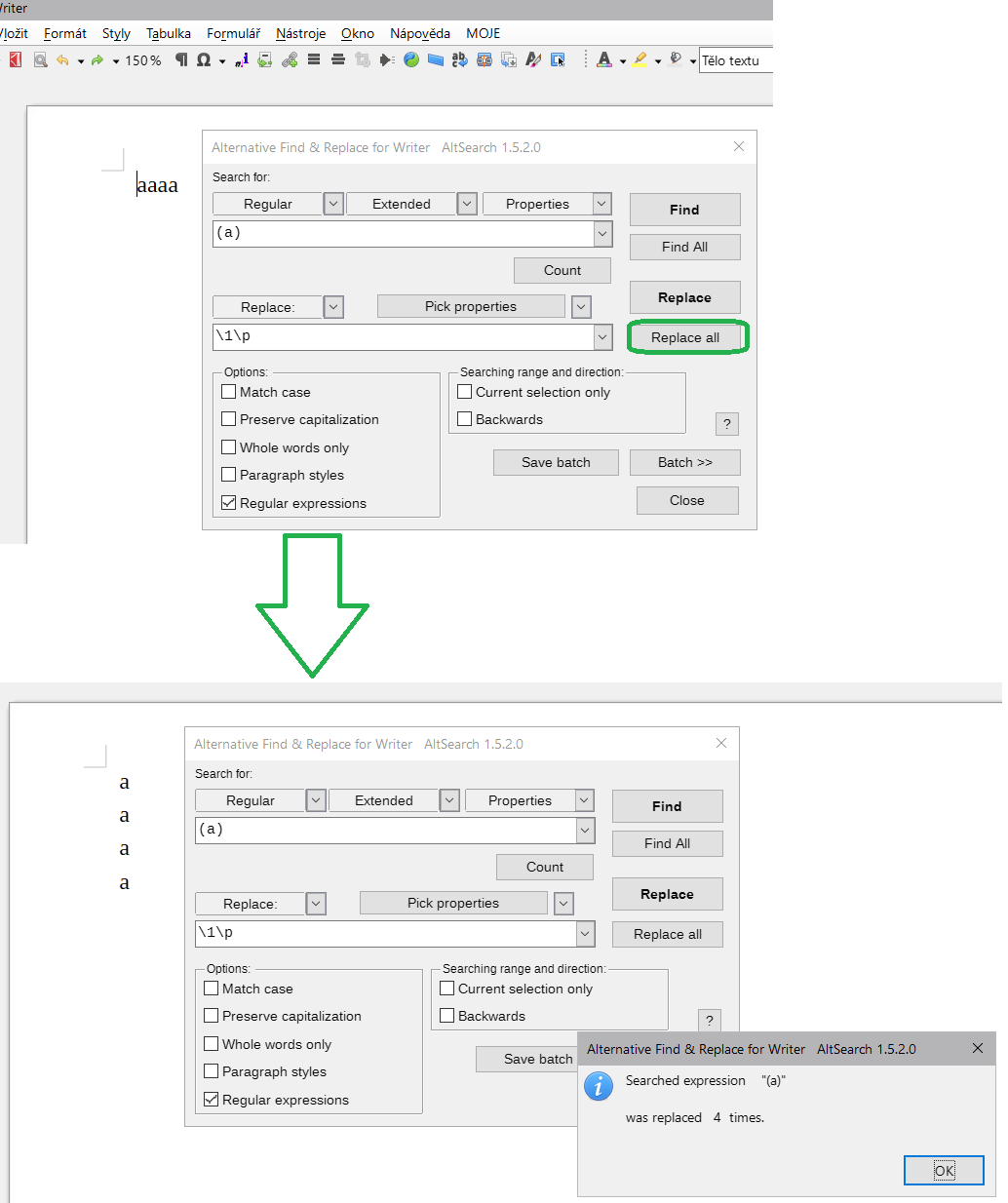

This works only when using the extension AltSearch.
To use that extension was suggested by @KamilLanda
Yes, sorry I misunderstood. Altsearch apparently doesn’t work for this function.
Unforrtunate. I also was unable to get Altsearch to do this.
@KamilLanda gave the link to the download page of the extension.
I hadn’t used AltSearch for a long time and had removed it. Now I got it from there, installed it, and it worked as described: One by one in the given case, but much faster than with manual selection.

Functional for me in AltSearch, but there are \. references for regex instead of $.
Find: (a)
Replace: \1\p
checked: Regular expressions
ran Replace all

in search box type \p and in replace box type \n
If others confirm this I can mark as solved.
It works only with Altsearch
