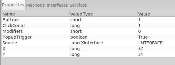

The first is noted as a Left click with Popup Trigger as True:
Screenshot at 2021-11-03 18-15-32

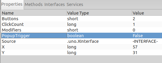

The second is a Right click with Popup Trigger as False:
Screenshot at 2021-11-03 18-15-45
