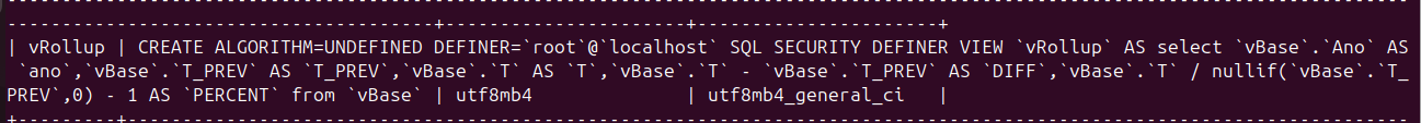

vBase returns the SUM(CASEs columns without parameters:
vRollup selects from vBase and must be completed as required in the question, of course:

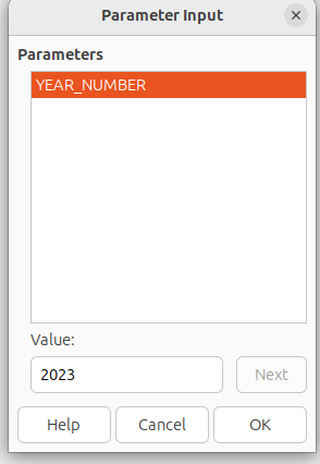

And this query runs with the year parameter via Base GUI parser:

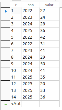

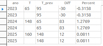

Will append the table 2 ~ 3 random values for each year and try to create View(s) grouped by year only (without the = value).
Or return just 1 value for other columns than YEAR (?) as my tentative views do (returns just 1 row for each “ano”).

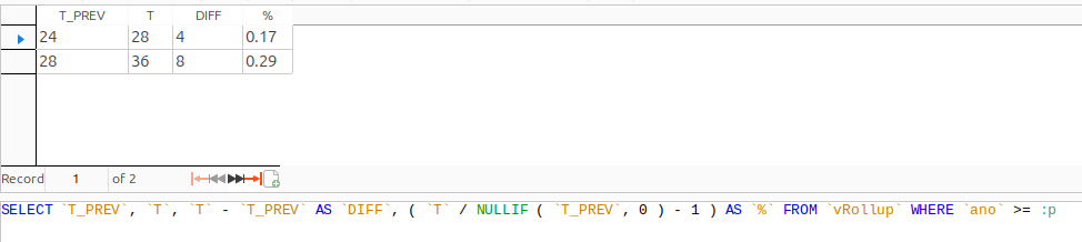

To see what results being called via Base GUI as
SELECT * FROM “vRollup” WHERE “year” = :p
I confirm, that it works that way with MariaSQL connected via JDBC and ODBC. I can’t get it working with SDBC, which may be a bug or my inexperience with that database engine.
SELECT *
FROM `dummy`.`vRollup` AS `vRollup`
WHERE `Year` = :Year_Number
