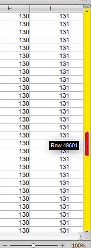

Clicking in the scrollbar area (yellow in the screenshot) either above or below the scroll handle (red in the screenshot) should move you up and down in a manner consistent with using the PageUp PageDown keys. You can click and hold for more rapid movement, depending on what the key repeat rate is set to on your operating system. In a spreadsheet with 80k rows dragging the scroll handle results in jumps of ~160 rows at a time (rather that the 1000 indicated) here - I also get a tooltip readout while dragging the scroll handle (black rectangle) indicating the row I am on.

Thanks for your reply. I don’t find the scrollbar area you reference. There is a square between an up and down arrow on the right most side of the screen. Above it is another arrow which expands the formula bar. If you have any idea of where to find the sensitivity setting, please let me know. I would like to make this program work for me if possible.
I have updated my answer for greater clarity. It sounds like it might be the “square between an up and down arrow on the right most side of the screen”.
