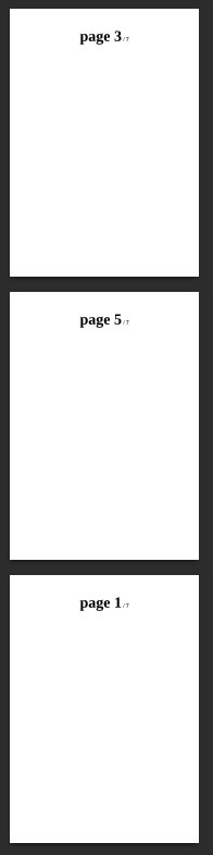

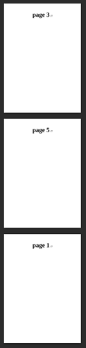

just tested with :
    filterProps(0).Name = "PageRange"
    filterProps(0).Value = "3,5,1"
got
